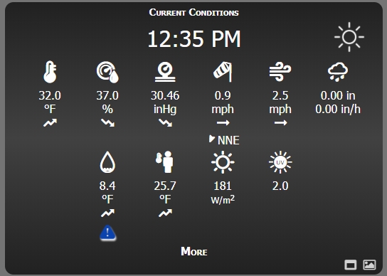

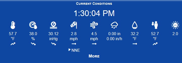

Both Current and Interactive blocks are showing the correct time for my site. I have no idea as to what would cause that issue.. :/
Current Block:
current conditions.jpg (34.02 KiB) Viewed 29490 times

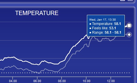

Interactive Block:
Interactive graph.jpg (39.8 KiB) Viewed 29490 times

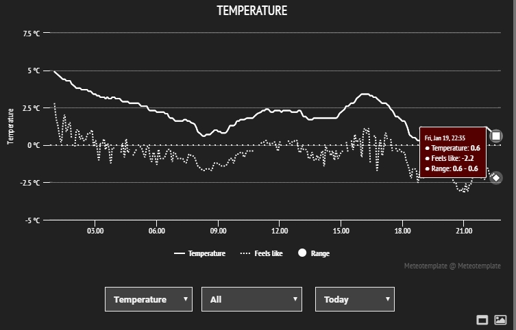

Re: Interactive Graph Time
Post by Dehatter » Fri Jan 19, 2018 8:45 pm
This is what it shows for me.
Post by Jachym » Fri Jan 19, 2018 9:14 pm
OK, so to make things even more mysterious... the EXACT same script (loaded from the same location) loads differently on its own and when on the homepage, can someone verify this?
http://www.meteotemplate.com/template/i ... ctiveGraph
http://www.meteotemplate.com/template/indexDesktop.php
jay_hoehn
Posts: 135
Location: Las Cruces, NM USA
Software: WeeWx
Post by jay_hoehn » Fri Jan 19, 2018 9:20 pm
Jachym,
I can confirm the problem. On the stand alone block the last datapoint reads 15:10 on the full page it reads 23:10.
Jay
Post by Jachym » Fri Jan 19, 2018 9:32 pm
OK try now please
(it is 10:32 PM, thats what it should show on my page)
jay_hoehn
Posts: 135
Software: WeeWx
Post by jay_hoehn » Fri Jan 19, 2018 9:42 pm
Jachym,
Now both read 22:34 for me. Maybe you found the issue?
Jay
Post by Jachym » Fri Jan 19, 2018 10:08 pm
Yes, I did make some changes, works for me as well
