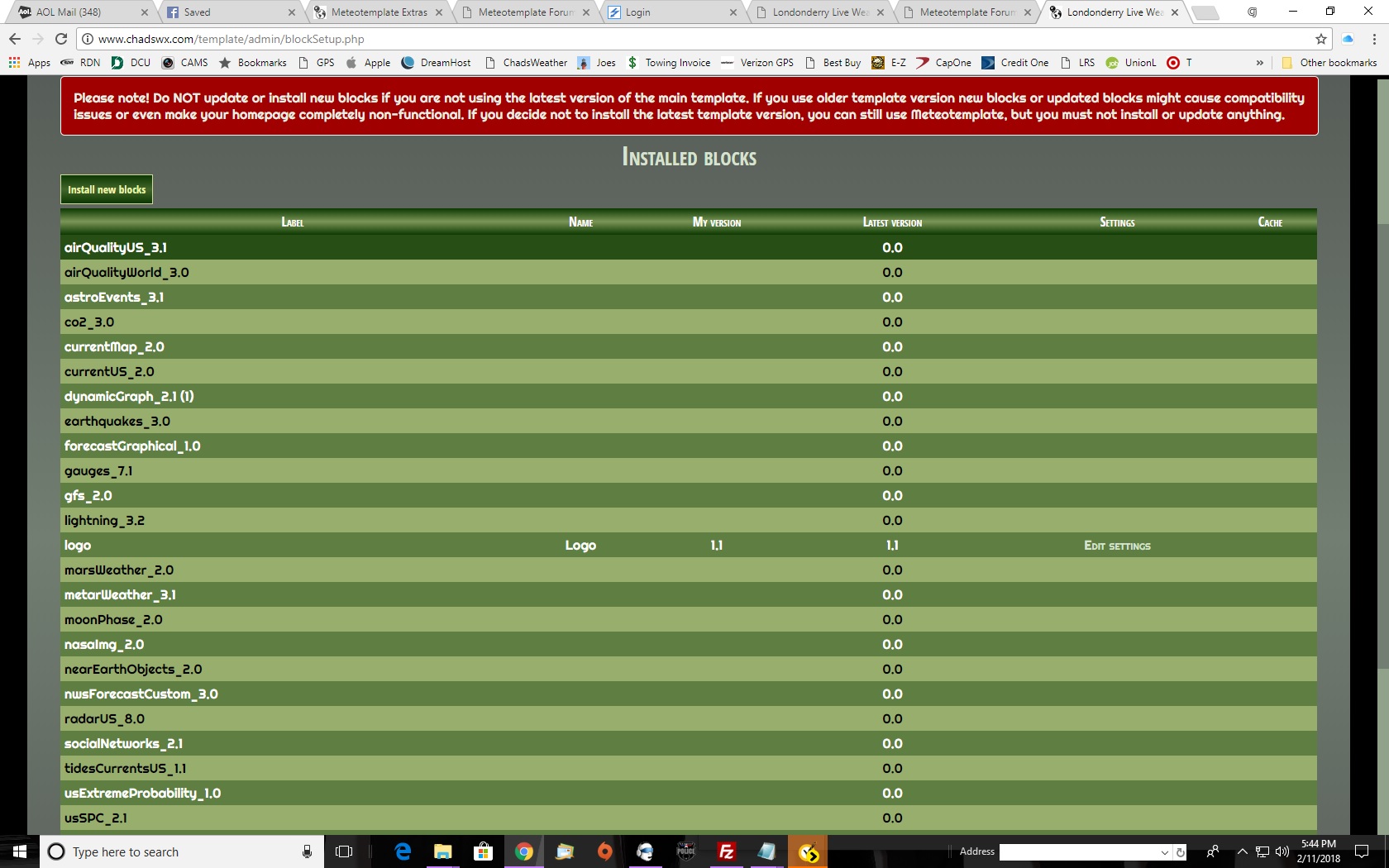

I am having a hard time understanding installing and uploading blocks to homepage, I have downloaded them, shows them in list but doesnt have versions next to them and when I go to add them to homepage I get spinning icons and says not installed?

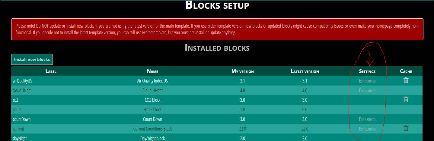

Post by Dehatter » Sun Feb 11, 2018 9:16 pm
Just to be clear.

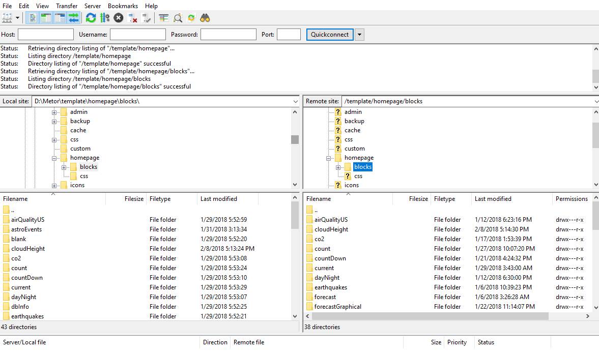

You used ftp and copied the block files to the /template/homepage/blocks folder on your server.
Then when you are logged in as an administrator, and go to the block setup tab, the block names are there, but do not have a version number? Do they show the "Create" or "Edit" setting as shown in the attached photo?

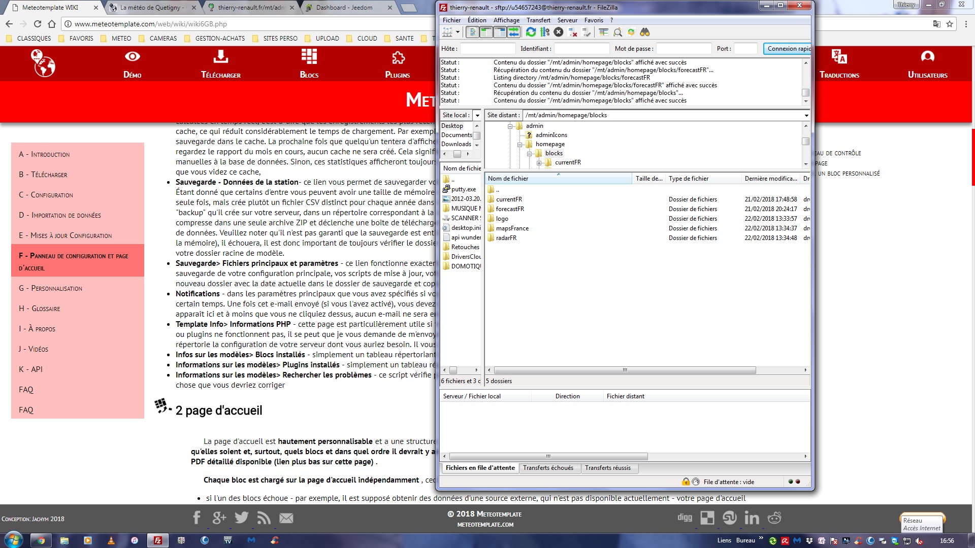

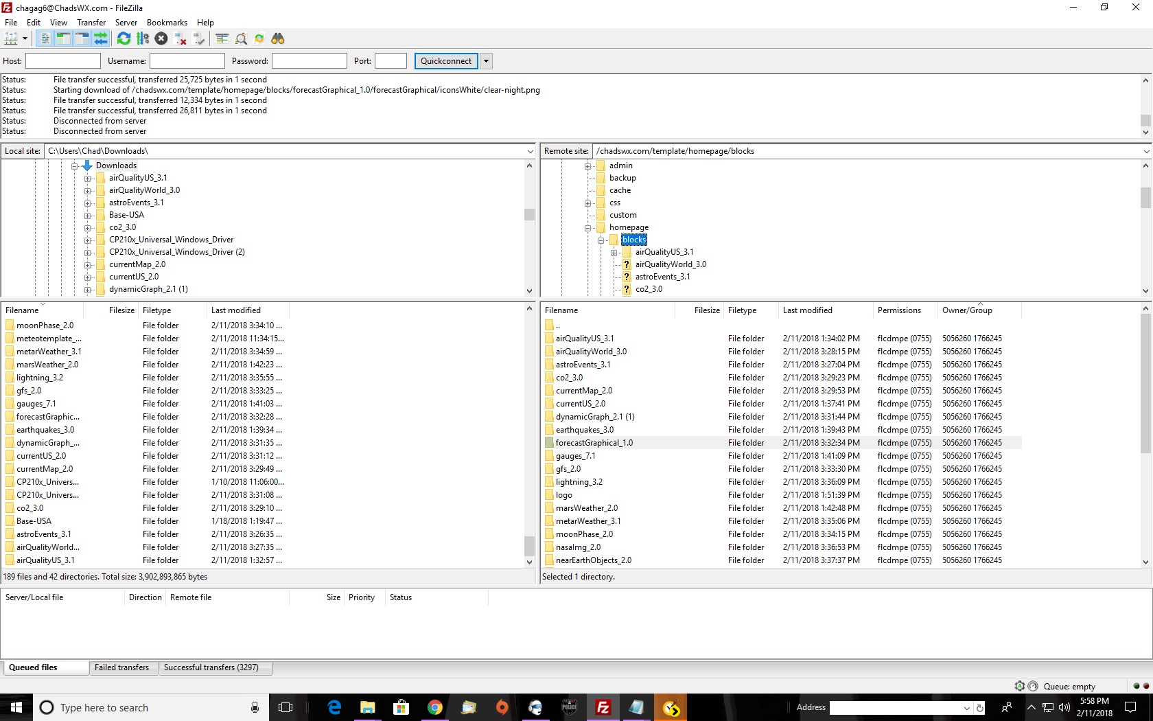

Here is the pic showing my filezila , all seems correct
BlueBear
Posts: 101
Station model: Davis VP2
Software: WeeWx
Re: I can not install blocks
Post by BlueBear » Sun Feb 11, 2018 11:05 pm
You appear to have renamed the uploaded the blocks
ie ../homepage/block/airQualityUS_3.1 should be ../homepage/blocks/airQualityUS without the version number!!

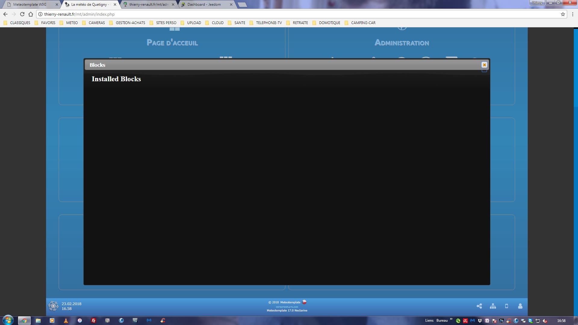

5 - je suis allé sur page d'accueil :PANNEAU DE CONTROLE / install /setup blocks puis INSTALLER DE NOUVEAUX BLOCKS
Résultat : RIEN
6 - je suis allé dans mon site en admin : PANNEAU DE CONTROLE /INFOS TEMPLATE/blocks installés
Résultat : RIEN

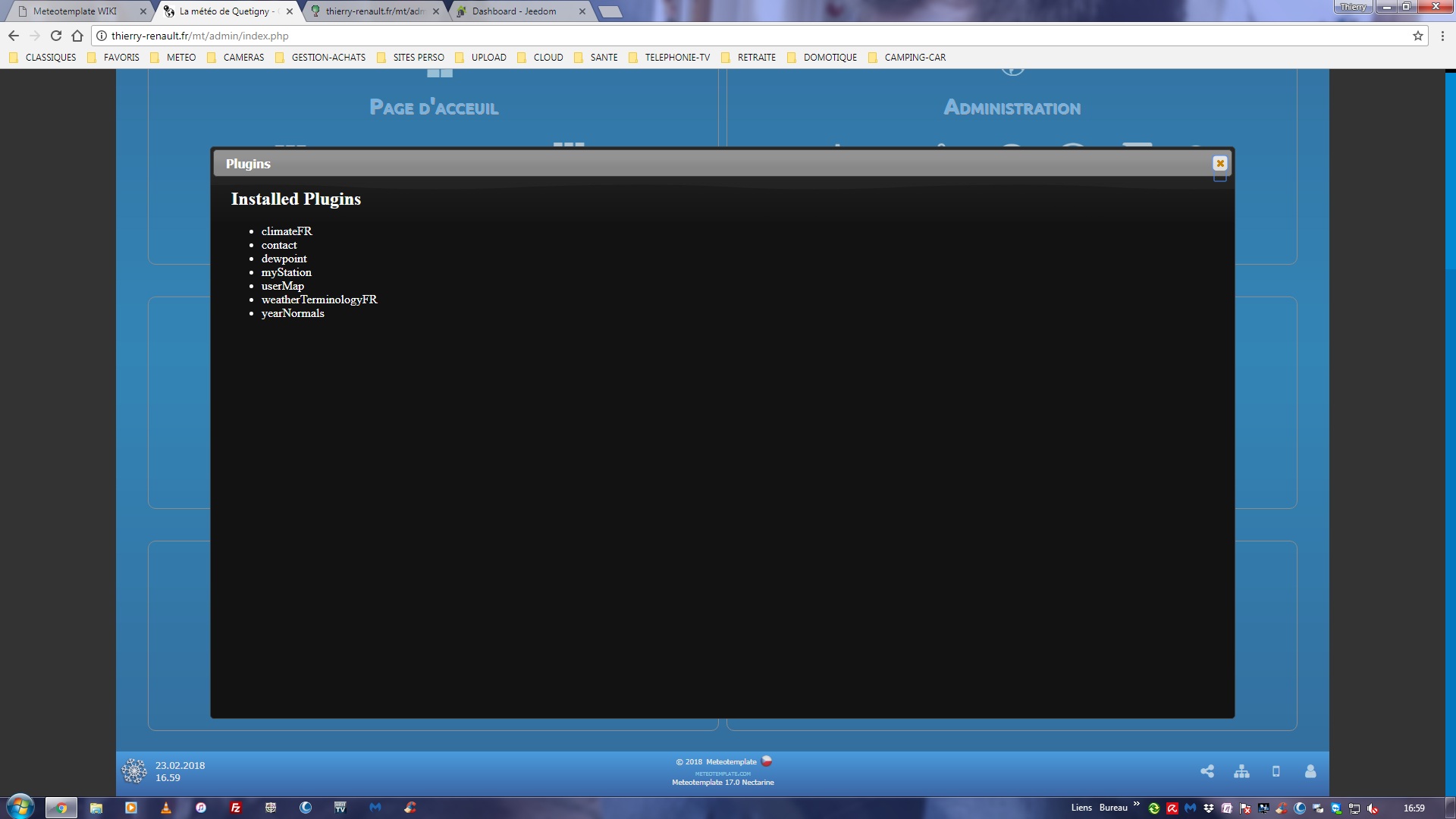

Oups ! je m'aperçois que mes pièces jointes ne sont pas vues.
Voilà ce qui m'arrive.
Je parviens bien à intégrer les plugins
Je ne parviens pas à intégrer les blocs
Est-ce que le chemin FTP est le bon ?????
Merci d'avance.
Post by Jachym » Sat Feb 24, 2018 9:59 pm
I tried on of the blocks, it should be like this:
http://thierry-renault.fr/mt/homepage/b ... RBlock.php
Either the path is not correct on your server or you need to check permissions.
From the screenshot it looks like you have the homepage folder inside "admin", this is incorrect, it must be in the root, admin is only for admin. Did you move some folders?
