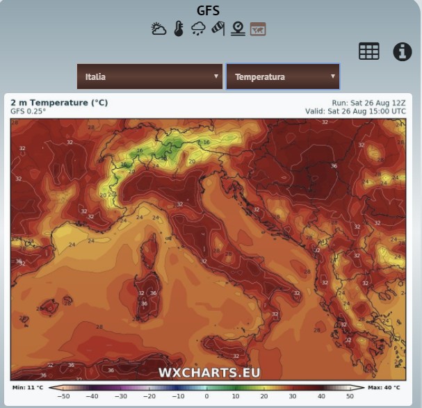

Post by meteoesine » Sat Aug 26, 2017 6:04 pm
I've installed GFS block on my homepage, set to start with a map, but always is displayed that of the temperature as default.
Is there any possibility to change the default map - for example 'overview' or another one instead of the temperature?

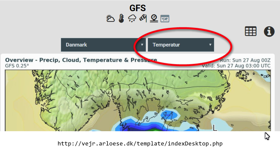

Anywhere i can change this to overview instead of temp?
also using the slider in the bottom it will shift from overview to temperature.

changing only the image is not enough: it does not well running
is it possible to modify the entire block using 'overview' (image and match code) as default instead of tempertature?

Post by Jachym » Mon Aug 28, 2017 9:18 am
You need to move the "selected" attribute from the "temp" option to the "overview" option so that it shows as selected in the select box as well

Post by georg » Mon Aug 28, 2017 9:47 am
Done !!!
Thanks a lot ----- fantastic and fast support :D :D :D :D

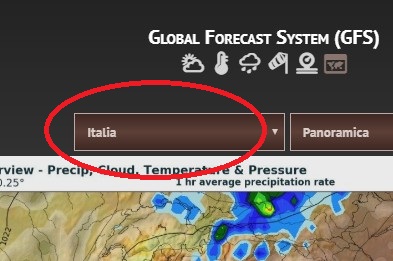

I have gfsMapSelector selected as default "Italy", can you pls explain how I can change the default as "Europe" ?
many thanks in advance
