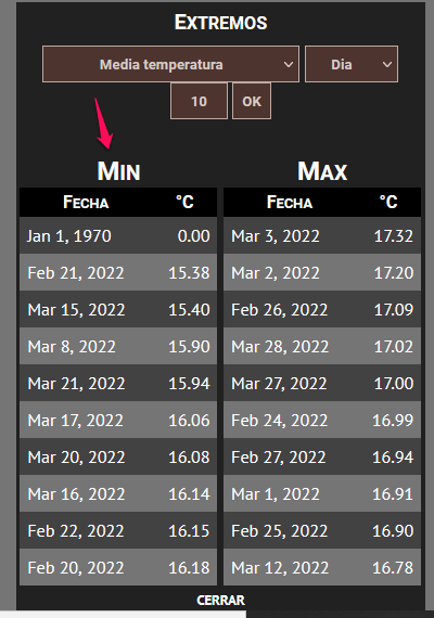

Hello. I have installed the "Extremes Block", and when looking at the list, the first minimum value of any of the variables is 0, registered on January 1, 1970. There is no value for that date; it is always 0. How can it be corrected?

Re: Extreme Block 1970
Post by davidefa » Mon Mar 28, 2022 12:49 pm
You can remove this erroneous data ( via the meteotemplate control panel ) database -> edit data and database -> edit data extra sensors, remove any data of 01/01/1970 ( it should be only one ).
If you have several of these wrong data it could be faster to remove them via phpmyadmin ( accessibkle via your hosting provider's control panel )

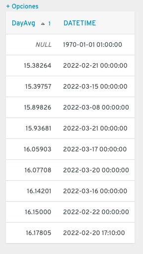

If I run the code I get the following:
Post by davidefa » Tue Mar 29, 2022 9:28 am
I'd say you have a record on 1970-01-01
This query ( in phpmyadmin ) should return exactly 1 result:
SELECT * FROM `alldata` WHERE DateTime <= '2020-01-01 00:00:00'
