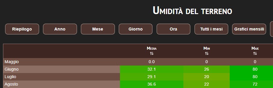

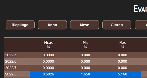

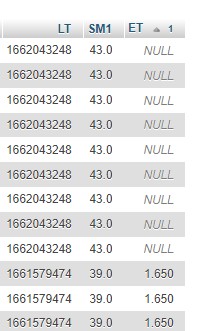

Re: minor problems with php 8.1
It's not a problem, but just a clarification:
my alldataExtra database was created in May,
in the statistics .../template/pages/station/climate.php?var=xxx it displays 0 although it should be null
there are no 0 values, is that correct?
tnx
tnx
Yes, null values should not be treated as 0 values ( noticed this even in other blocks pages ).
