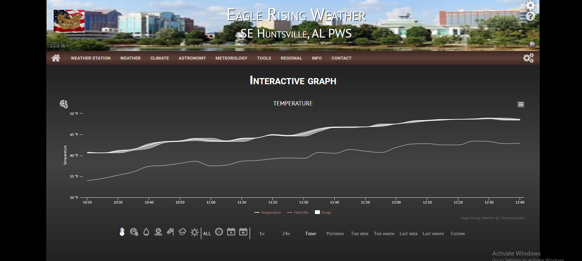

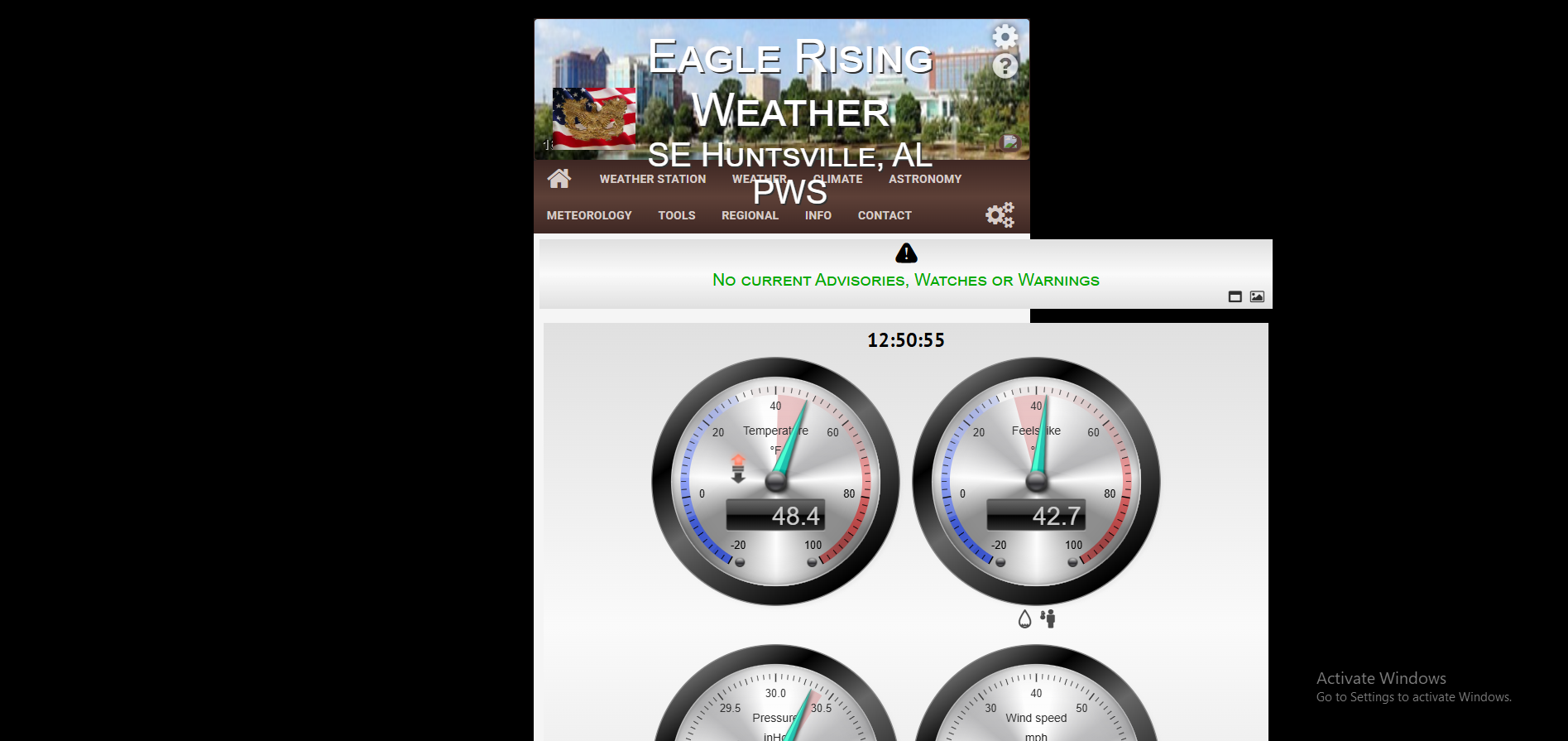

When my Homepage is displayed, the layout looks to be constrained (ie. the blocks are too big to correctly fit in the allocated column width). See attached Homepage snipit.
However, when I click on a menu item, the layout looks correct. See "correct layout" attachment.
I've tried other browsers to rule out a nuance between browsers as well as using a different version of PHP neither of which provides a different result. I haven't made any changes to my control files or home page settings but it almost looks like the template thinks that my one column that I'm using is smaller than it actually is.
Interestingly, when the homepage initially loads, it displays correctly for a couple of seconds then gets constrained. I also noticed that the links to my first 4 menu items are not accessible from the homepage but ARE accessible if you bring them up threw one of the other menus.
