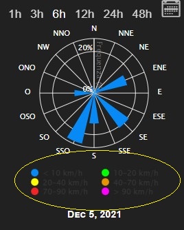

Jolumarali
Posts: 252
Location: Lignerolles
Station model: Vantage Vue
Software: WlIP
Re: Wind rose
Post by Jolumarali » Sat Dec 04, 2021 11:11 am
same, no change
Block modified on my page
thanks again

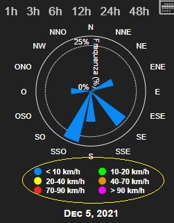

Re: Wind rose
Post by meteoesine » Sun Dec 05, 2021 8:57 am
I also found this curious effect that happens in a completely random way:
In my specific case, if it does not display the X-axis, the legend writings are displayed with the white color that must be;
if it displays the X-axis the color of the legend's characters changes.
mysterious mysteries :D
Jolumarali
Posts: 252
Software: WlIP
Re: Wind rose
Post by Jolumarali » Sun Dec 05, 2021 5:21 pm
Good evening
in night mode, that happens for me too, on the other hand in day mode, no problem with the color of the characters.

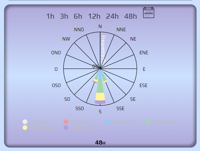

Meteofabro
Posts: 41
Location: Fabro
Software: Meteobridge RED PRO
Re: Wind rose
Post by Meteofabro » Sat Feb 19, 2022 11:37 am
I have installed the windrose block. Is it possible to change the color of the wind speed range texts?.
In automatic mode it gives me a color not visible with the template settings.
2022-02-19 12_15_57-MeteoFabro.png (62.31 KiB) Viewed 19495 times
Re: Wind rose
Post by davidefa » Sun Feb 20, 2022 12:01 am
ver 1.3
Added an option to define legend text color
windRose_1.3.zip
(4.66 KiB) Downloaded 657 times

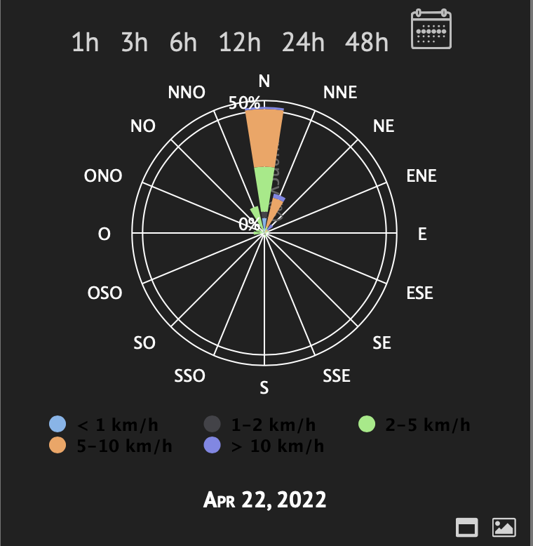

Saszalez
Posts: 17
Joined: Thu Feb 24, 2022 1:51 pm
Software: WeatherLink
Re: Rosa del viento
Post by Saszalez » Fri Apr 22, 2022 8:30 am
The legend's text is printed dark for me now, and it is not visible.
Captura de Pantalla 2022-04-22 a las 9.28.50.png (96.85 KiB) Viewed 19164 times
mchd17
Posts: 196
Location: Illinois
Re: Wind rose
Post by mchd17 » Fri Apr 22, 2022 10:59 am
Same here, default color not working.
